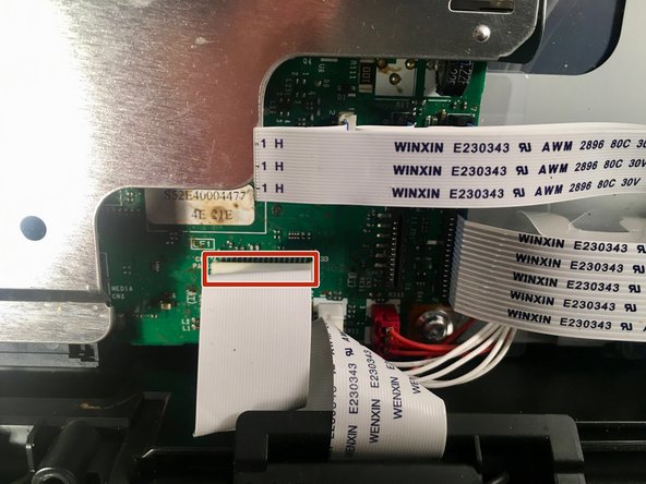

  • Remove the control panel flat cable.
  • Remove the ink refill sensor flat cable.
  • Remove the following cables:
  • Carriage PCB flat cable 1
  • Carriage PCB flat cable 2
  • Carriage PCB flat cable 3
