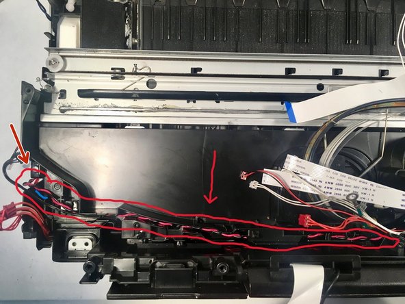

  30. MFC-J4410DW Flushing Box Replacement: crwdns2935265:030crwdnd2935265:01crwdnd2935265:03crwdne2935265:0 MFC-J4410DW Flushing Box Replacement: crwdns2935265:030crwdnd2935265:02crwdnd2935265:03crwdne2935265:0 MFC-J4410DW Flushing Box Replacement: crwdns2935265:030crwdnd2935265:03crwdnd2935265:03crwdne2935265:0
    • De-route the switchback sensor harness (black) and the paper feed motor harness (red and black) from the left side of the tube support plate.
    • De-route the speaker harness (red and black), purge cam sensor harness (white, three-wire), registration sensor harness (orange), ink cover sensor harness (white, two-wire), carriage motor harness (red and black), and FG wire (green) from the right side of the tube support plate.
    • De-route the ink refill sensor flat cable from the tube support plate.

  34. MFC-J4410DW Flushing Box Replacement: crwdns2935265:034crwdnd2935265:01crwdnd2935265:02crwdne2935265:0 MFC-J4410DW Flushing Box Replacement: crwdns2935265:034crwdnd2935265:02crwdnd2935265:02crwdne2935265:0
    • De-route the FG wire (green), the purge cam sensor harness (white), and the registration sensor harness (orange) from the right side of the machine.
    • Remove the magnet attached to the carriage motor harness (red and black) from its slot.

Hi there.
Great guide - although some pics of re-assembly and re-routing of the cables that were de-routed would have been very helpful. I am a complete novice and I followed this guide to the letter. I was successful in installing both boxes and re-assembling the printer so that on my initial power up it showed a fully usable touchscreen. However I then had a problem where it would not detect (any of) the ink cartridges.
I thought it might have been a loose connection and went as far back as re-seating the connections on the main PCB frame. After that the touchscreen display just remained blank.
I can’t think what I could have screwed up in re-seating things. One step forward - two steps back !
If anyone reads this and has some idea I would appreciate any assistance.
Cheers
S
JK SS - crwdns2934203:0crwdne2934203:0 crwdns2950251:0crwdne2950251:0
When fixing the tube support plate be careful to have the blck cables of the switchback sensor harness pulled out as far as possible, it will be stuck under the plate and too short to plug it in again.
Bernd
