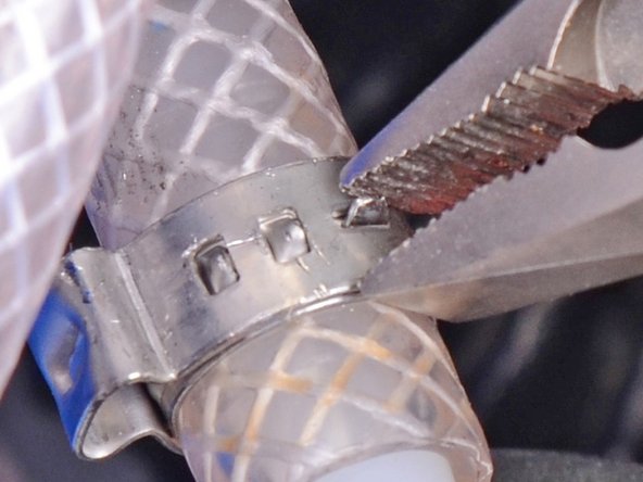

  • Remove the crimped hose clamps securing from each end of the pump you are replacing.
  • You can use a clamp removal tool to cut the clamps.
  • Alternatively, use pliers to unlatch the small retaining tab on the clamp.
  • Pry the clamp apart to loosen it.
  • Use your fingers or pliers to pull the hoses off of the pump nozzles.
  • The hoses will leak liquids when pulled out.
  • This will take significant force. If you are having trouble, heat the hose ends with a hair dryer or heat gun, and try again.
