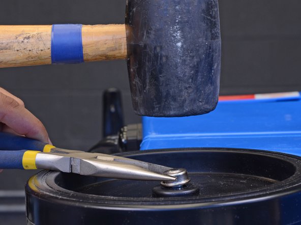

      • Before you begin disassembly, make sure that the Rug Doctor is not plugged in and that all reservoirs are empty of liquids.
      • Use pliers to grip and wiggle the axle hub cap to loosen it.
      • Pull the axle cap off.
      • If you are having trouble, pry under the cap to loosen it from the axle.

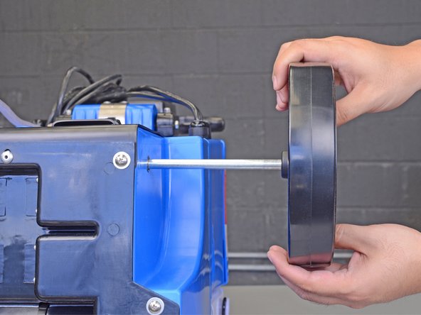

    3. Rug Doctor Pump Replacement: crwdns2935265:03crwdnd2935265:01crwdnd2935265:03crwdne2935265:0 Rug Doctor Pump Replacement: crwdns2935265:03crwdnd2935265:02crwdnd2935265:03crwdne2935265:0 Rug Doctor Pump Replacement: crwdns2935265:03crwdnd2935265:03crwdnd2935265:03crwdne2935265:0
      • Pull the wheel off of the axle.
      • Pull the other wheel with the attached axle out of the body.
      • Re-assembly tip—to reinstall the wheels and axle:
      • Slide the axle and wheels back onto the Rug Doctor.
      • Center a replacement axle hub cap over the exposed axle end.
      • Use a mallet to tap the hub cap in place. It should not feel loose on the axle.

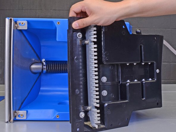

    7. Rug Doctor Pump Replacement: crwdns2935265:07crwdnd2935265:01crwdnd2935265:02crwdne2935265:0 Rug Doctor Pump Replacement: crwdns2935265:07crwdnd2935265:02crwdnd2935265:02crwdne2935265:0
      • Beginning from the bristle end, carefully pull the bottom pan away from the body, to gain access to the pumps.
      • This will loosen the front metal blade. It may be helpful to temporarily reinstall a screw to hold it in place while you work.

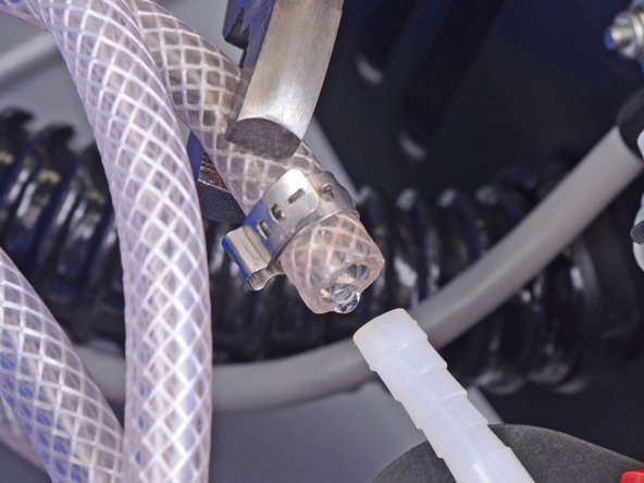

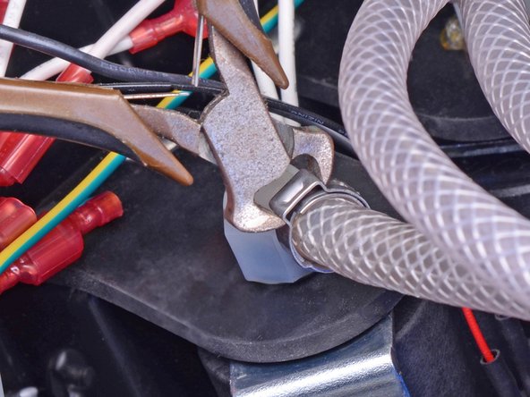

      • Remove the crimped hose clamps securing from each end of the pump you are replacing.
      • You can use a clamp removal tool to cut the clamps.
      • Alternatively, use pliers to unlatch the small retaining tab on the clamp.
      • Pry the clamp apart to loosen it.
      • Use your fingers or pliers to pull the hoses off of the pump nozzles.
      • The hoses will leak liquids when pulled out.
      • This will take significant force. If you are having trouble, heat the hose ends with a hair dryer or heat gun, and try again.

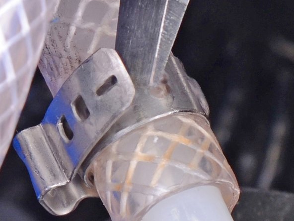

      • Re-assembly tip—to reinstall the crimp-style hose clamps:
      • Slide the clamp onto the hose, leaving 1/2" of hose at the end.
      • Use hose clamp pliers or straight edge cutters to squeeze and crimp the clamp ears.
