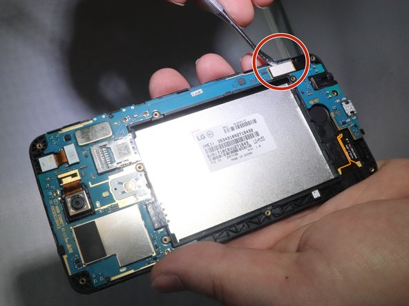

  • Unplug the video card from the motherboard with a spudger or plastic opening tool.
  • Using the metal spudger as shown in the photos has the potential to damage your device.
