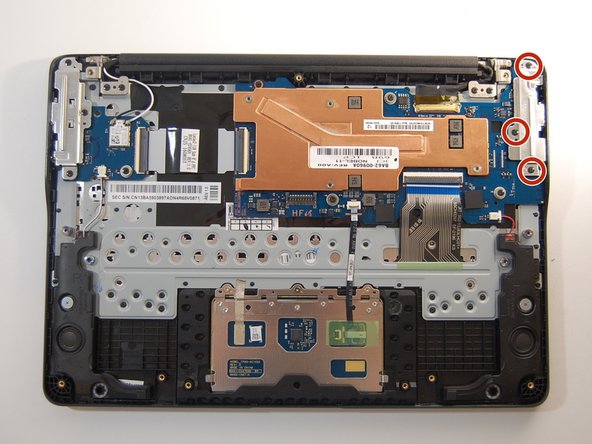

  • Remove the three 4.6mm screws from the silver port cover using a Phillips #00 screwdriver.
  • The port cover will take a little wiggling to lift up and out of the laptop.
