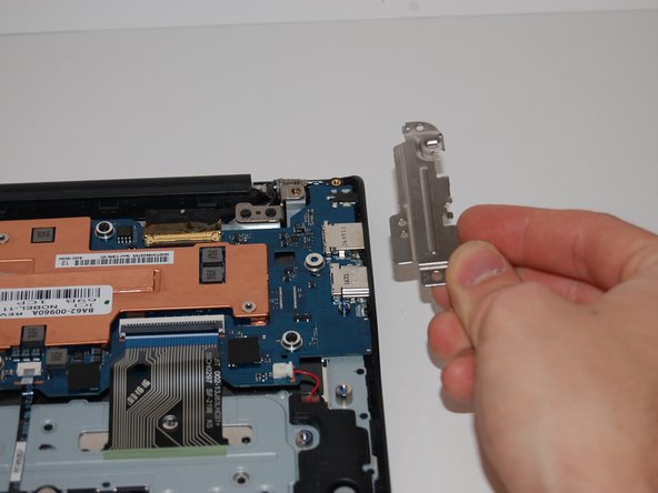

    • Remove the three 4.6mm screws from the silver port cover using a Phillips #00 screwdriver.
    • The port cover will take a little wiggling to lift up and out of the laptop.

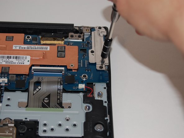

  8. Samsung Chromebook 3 XE500C13-K02US Motherboard Replacement: crwdns2935265:08crwdnd2935265:01crwdnd2935265:02crwdne2935265:0 Samsung Chromebook 3 XE500C13-K02US Motherboard Replacement: crwdns2935265:08crwdnd2935265:02crwdnd2935265:02crwdne2935265:0

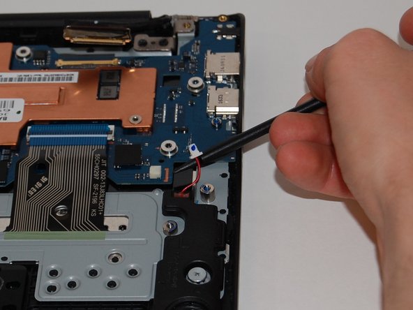

    • Remove the right speaker connector using a spudger.
  9. Samsung Chromebook 3 XE500C13-K02US Motherboard Replacement: crwdns2935265:09crwdnd2935265:01crwdnd2935265:03crwdne2935265:0 Samsung Chromebook 3 XE500C13-K02US Motherboard Replacement: crwdns2935265:09crwdnd2935265:02crwdnd2935265:03crwdne2935265:0 Samsung Chromebook 3 XE500C13-K02US Motherboard Replacement: crwdns2935265:09crwdnd2935265:03crwdnd2935265:03crwdne2935265:0

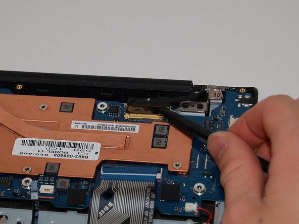

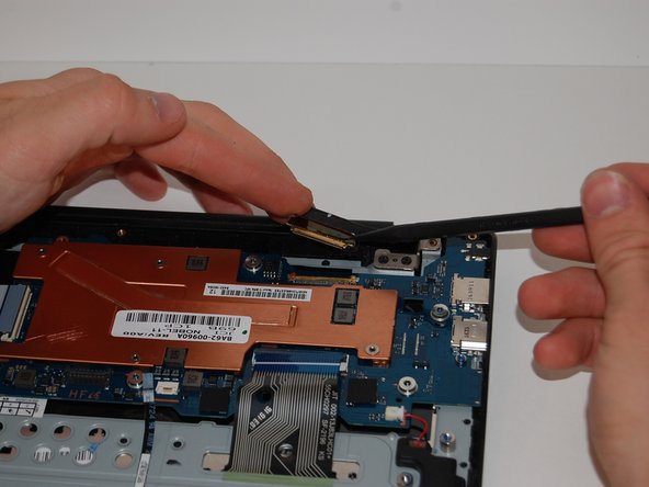

    • Use a spudger to lift the hinge locking the gold colored display cable in place.
    • Slide the hinge out to remove it from the motherboard.

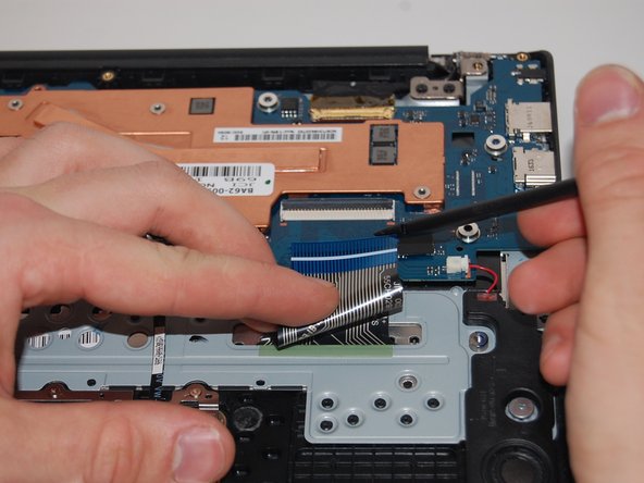

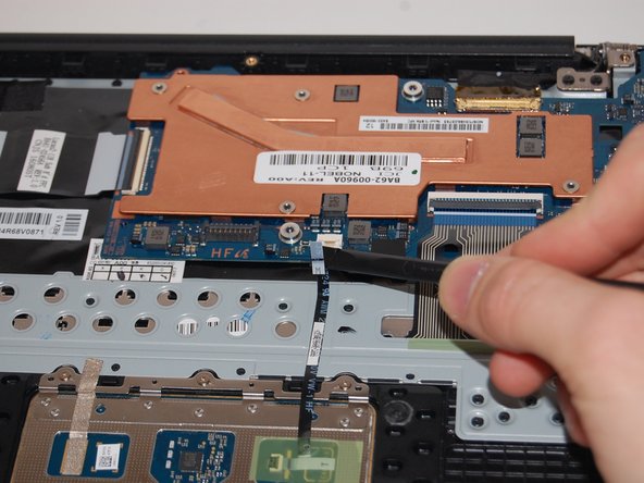

    • Use a spudger to flip up the ZIF connector holding in the ribbon cable.
    • Once the ZIF connector has been lifted, slide the ribbon cable out of the motherboard.
  11. Samsung Chromebook 3 XE500C13-K02US Motherboard Replacement: crwdns2935265:011crwdnd2935265:01crwdnd2935265:02crwdne2935265:0 Samsung Chromebook 3 XE500C13-K02US Motherboard Replacement: crwdns2935265:011crwdnd2935265:02crwdnd2935265:02crwdne2935265:0
    • Slide the track pad ribbon cable out from the motherboard using a spudger.
  12. Samsung Chromebook 3 XE500C13-K02US Motherboard Replacement: crwdns2935265:012crwdnd2935265:01crwdnd2935265:02crwdne2935265:0 Samsung Chromebook 3 XE500C13-K02US Motherboard Replacement: crwdns2935265:012crwdnd2935265:02crwdnd2935265:02crwdne2935265:0

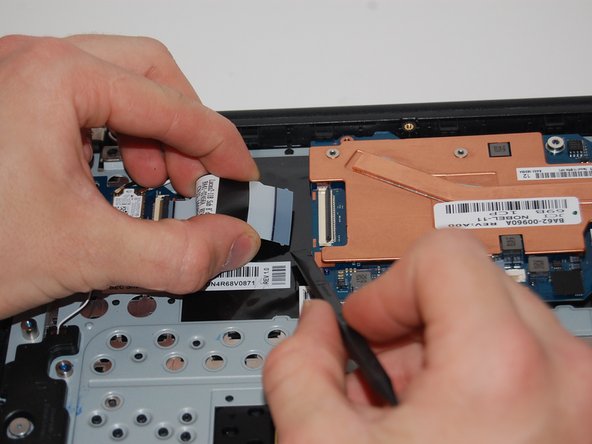

    • Lift the ZIF connector on the keyboard ribbon cable with a spudger.
    • Once the ZIF connector has been flipped, slide the ribbon cable out from the motherboard.

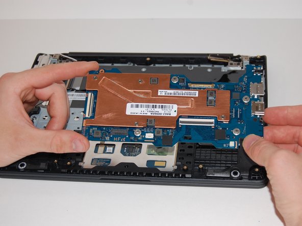

  13. Samsung Chromebook 3 XE500C13-K02US Motherboard Replacement: crwdns2935265:013crwdnd2935265:01crwdnd2935265:03crwdne2935265:0 Samsung Chromebook 3 XE500C13-K02US Motherboard Replacement: crwdns2935265:013crwdnd2935265:02crwdnd2935265:03crwdne2935265:0 Samsung Chromebook 3 XE500C13-K02US Motherboard Replacement: crwdns2935265:013crwdnd2935265:03crwdnd2935265:03crwdne2935265:0
    • Use your Phillips #00 screwdriver to remove four 4.6mm screws from the motherboard.
    • Ensure there are no cables in the way and lift the motherboard up and out of the laptop.
