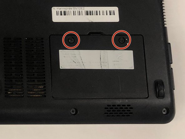

  • Remove the RAM access door.
  • Remove the two 3mm screws using a Phillips #0 screwdriver.
  • Gently lift on the door out of place.
  • When replacing the door it should click into place. Ensure the alignment tabs are correctly seated and gently push until it clicks into place.
