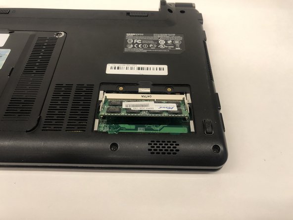

  4. Hannspree SN12E2 RAM Replacement, RAM: crwdns2935265:04crwdnd2935265:01crwdnd2935265:02crwdne2935265:0 Hannspree SN12E2 RAM Replacement, RAM: crwdns2935265:04crwdnd2935265:02crwdnd2935265:02crwdne2935265:0
    • Remove the RAM access door.
    • Remove the two 3mm screws using a Phillips #0 screwdriver.
    • Gently lift on the door out of place.
    • When replacing the door it should click into place. Ensure the alignment tabs are correctly seated and gently push until it clicks into place.
  5. Hannspree SN12E2 RAM Replacement: crwdns2935265:05crwdnd2935265:01crwdnd2935265:03crwdne2935265:0 Hannspree SN12E2 RAM Replacement: crwdns2935265:05crwdnd2935265:02crwdnd2935265:03crwdne2935265:0 Hannspree SN12E2 RAM Replacement: crwdns2935265:05crwdnd2935265:03crwdnd2935265:03crwdne2935265:0
    • Gently push outward on the two retaining clips, being careful not to damage the motherboard.
    • Lift up on the RAM until it makes a 35 degree angle with the board.
    • Remove the RAM by pulling away from the housing at 35 degrees.
