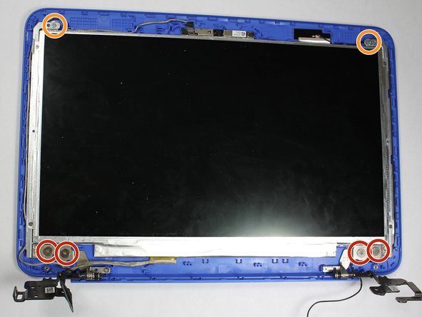

  • Remove the four (4) Phillips P0 PM2.5x4.5 mm screws.
  • Place four (4) screws on magnetic mat for reassembly.
  • Remove the two (2) Phillips P0 PM2.5x3.0 mm screws.
  • Place two (2) screws on magnetic mat for reassembly.
