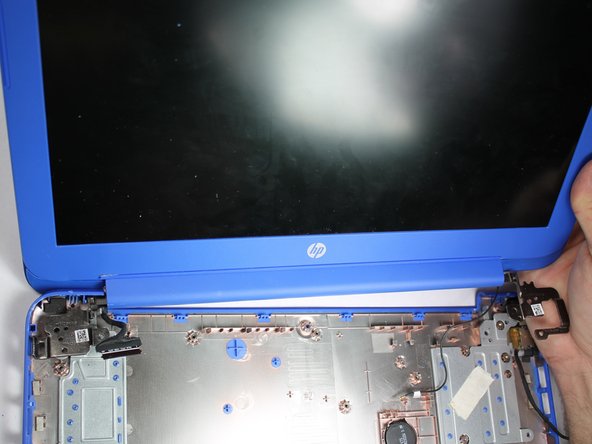

  11. HP Stream 13-c110nr Display Replacement, Display Assembly: crwdns2935265:011crwdnd2935265:01crwdnd2935265:01crwdne2935265:0
    • Disconnect the Display Cable from the System Board.
  12. HP Stream 13-c110nr Display Replacement: crwdns2935265:012crwdnd2935265:01crwdnd2935265:03crwdne2935265:0 HP Stream 13-c110nr Display Replacement: crwdns2935265:012crwdnd2935265:02crwdnd2935265:03crwdne2935265:0 HP Stream 13-c110nr Display Replacement: crwdns2935265:012crwdnd2935265:03crwdnd2935265:03crwdne2935265:0

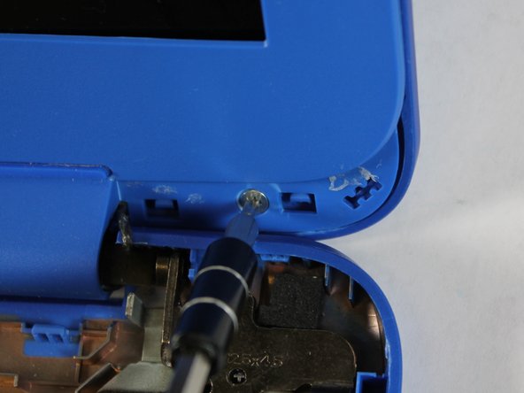

    • Remove the four (4) Phillips P0 PM2.5x4.5 mm screws from the screen retaining brackets.
    • Place the four (4) screws on the magnetic mat for reassembly.

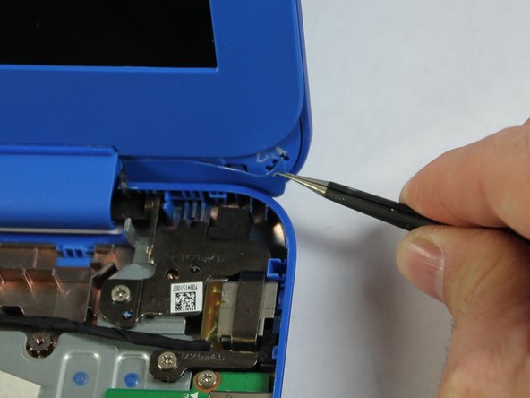

    • Peel off two (2) stickers located at the bottom corners of the display assembly.
    • Place two (2) stickers in safe place for reassembly.

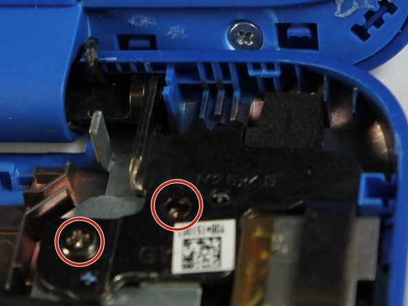

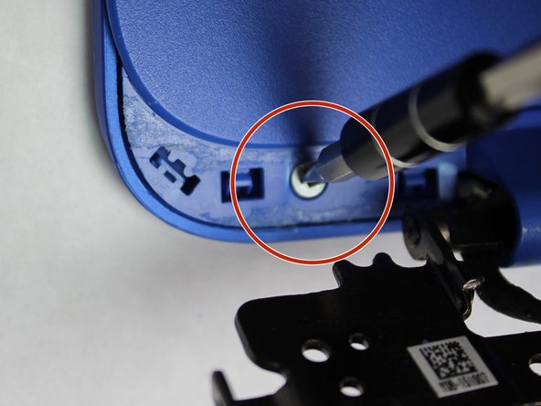

    • Remove the two (2) Phillips P0 PM2.5x2.0 mm screws.
    • Place the two (2) screws on the magnetic mat for reassembly.

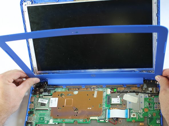

    • Use a pick to pry off the display cover from the display.
  16. HP Stream 13-c110nr Display Replacement: crwdns2935265:016crwdnd2935265:01crwdnd2935265:01crwdne2935265:0

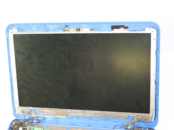

    • Remove the Display Assembly.
  17. HP Stream 13-c110nr Display Replacement: crwdns2935265:017crwdnd2935265:01crwdnd2935265:02crwdne2935265:0 HP Stream 13-c110nr Display Replacement: crwdns2935265:017crwdnd2935265:02crwdnd2935265:02crwdne2935265:0

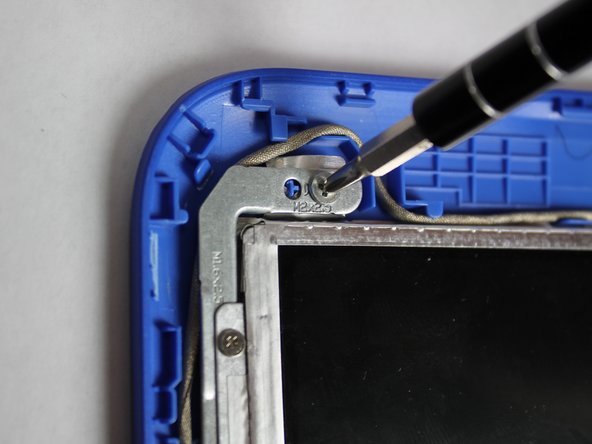

    • Remove the four (4) Phillips P0 PM2.5x4.5 mm screws.
    • Place four (4) screws on magnetic mat for reassembly.
    • Remove the two (2) Phillips P0 PM2.5x3.0 mm screws.
    • Place two (2) screws on magnetic mat for reassembly.
  18. HP Stream 13-c110nr Display Replacement: crwdns2935265:018crwdnd2935265:01crwdnd2935265:01crwdne2935265:0
    • Separate display from back cover
