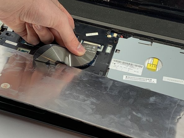

  • Once you pop it out and its separated, slowly turn it over to reveal its attachment to the connector.
  • Do not pull the keyboard out too hard because you risk damaging both the connector and the laptop.
