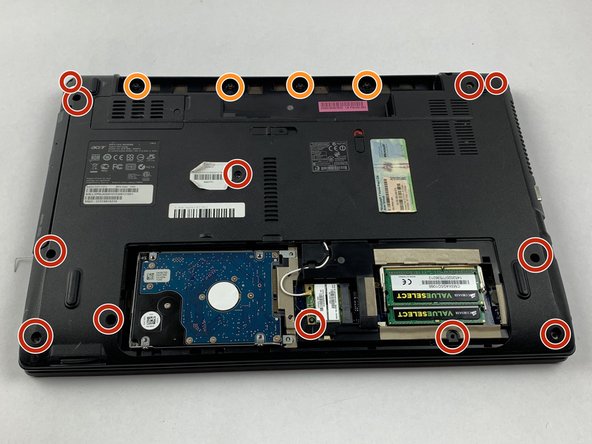

    • Remove all 12 of the 7.6 mm screws on the backside with a Phillips #0 screwdriver.
    • Remove 4 of the 5.4 mm screws on the backside with a Phillips #00 screwdriver.
