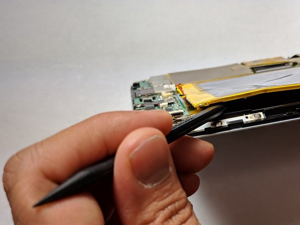

HP 7 PLUS 1301 Battery Replacement
crwdns2935425:05crwdne2935425:0
HP 7 PLUS 1301 Battery Replacement: crwdns2935265:00crwdnd2935265:01crwdnd2935265:01crwdne2935265:0
  • Carefully remove the battery by sliding a plastic spudger under the battery. Use an adhesive remover if available under the battery to make it easier for the battery to come off.
