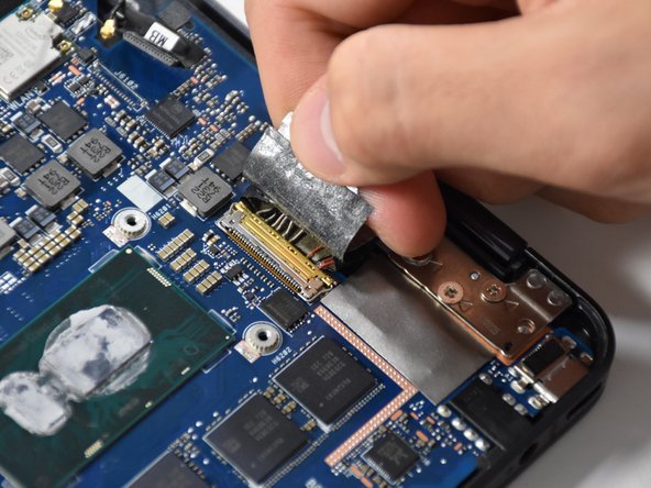

  • Pull up the tap of the biggest connector using your fingers.
  • Lift the gold hinge using a plastic opening tool.
  • Lift the connector up with your fingers to remove.
