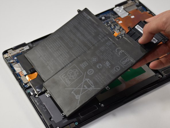

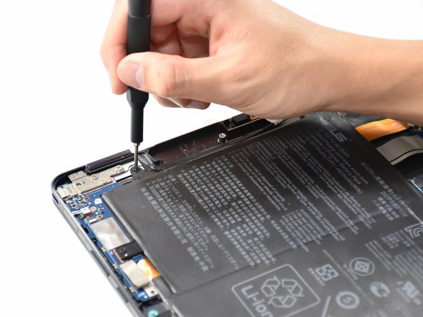

  5. Asus Q325U Motherboard Replacement, Battery: crwdns2935265:05crwdnd2935265:01crwdnd2935265:02crwdne2935265:0 Asus Q325U Motherboard Replacement, Battery: crwdns2935265:05crwdnd2935265:02crwdnd2935265:02crwdne2935265:0
    • Remove the seven 5mm screws around the battery using a Phillips #00 screwdriver.
  6. Asus Q325U Motherboard Replacement: crwdns2935265:06crwdnd2935265:01crwdnd2935265:02crwdne2935265:0 Asus Q325U Motherboard Replacement: crwdns2935265:06crwdnd2935265:02crwdnd2935265:02crwdne2935265:0
    • Using a Phillips #000 screwdriver, remove the two 3mm screws on top of the orange battery connector.
  7. Asus Q325U Motherboard Replacement: crwdns2935265:07crwdnd2935265:01crwdnd2935265:02crwdne2935265:0 Asus Q325U Motherboard Replacement: crwdns2935265:07crwdnd2935265:02crwdnd2935265:02crwdne2935265:0
    • Lift the battery out from the laptop.

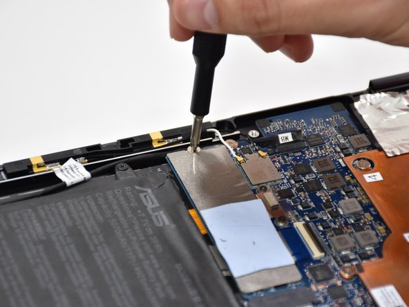

  8. Asus Q325U Motherboard Replacement, Copper Plate: crwdns2935265:08crwdnd2935265:01crwdnd2935265:02crwdne2935265:0 Asus Q325U Motherboard Replacement, Copper Plate: crwdns2935265:08crwdnd2935265:02crwdnd2935265:02crwdne2935265:0
    • Remove the six 3mm screws using a Phillips #00.

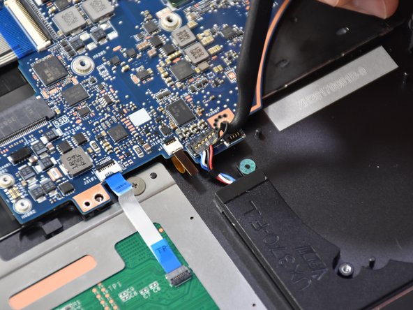

  11. Asus Q325U Motherboard Replacement, CPU Fan: crwdns2935265:011crwdnd2935265:01crwdnd2935265:02crwdne2935265:0 Asus Q325U Motherboard Replacement, CPU Fan: crwdns2935265:011crwdnd2935265:02crwdnd2935265:02crwdne2935265:0
    • Remove the three 3.7 mm screws using a Phillips #00 screwdriver.
  12. Asus Q325U Motherboard Replacement: crwdns2935265:012crwdnd2935265:01crwdnd2935265:01crwdne2935265:0
    • Detach the black wire and plug shown using a tweezer.
  13. Asus Q325U Motherboard Replacement: crwdns2935265:013crwdnd2935265:01crwdnd2935265:01crwdne2935265:0
    • Grab CPU fan by its edge and gently pull upwards to remove.

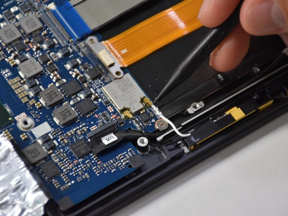

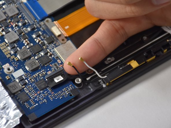

  14. Asus Q325U Motherboard Replacement, Motherboard: crwdns2935265:014crwdnd2935265:01crwdnd2935265:02crwdne2935265:0 Asus Q325U Motherboard Replacement, Motherboard: crwdns2935265:014crwdnd2935265:02crwdnd2935265:02crwdne2935265:0
    Halberd Spudger
    $2.99

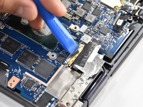

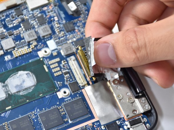

    • Remove the first connection wire by pulling the small back loop with the Halberd Spudger.

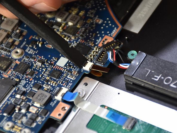

  15. Asus Q325U Motherboard Replacement: crwdns2935265:015crwdnd2935265:01crwdnd2935265:03crwdne2935265:0 Asus Q325U Motherboard Replacement: crwdns2935265:015crwdnd2935265:02crwdnd2935265:03crwdne2935265:0 Asus Q325U Motherboard Replacement: crwdns2935265:015crwdnd2935265:03crwdnd2935265:03crwdne2935265:0
    • Lift the small black tab of the orange connector with your fingers or a plastic opening tool.
    • Remove the orange connector by pulling with tweezers.

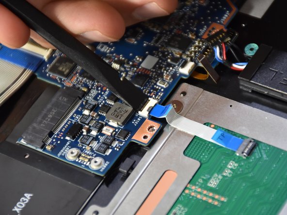

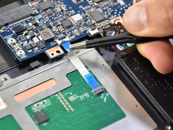

  16. Asus Q325U Motherboard Replacement: crwdns2935265:016crwdnd2935265:01crwdnd2935265:03crwdne2935265:0 Asus Q325U Motherboard Replacement: crwdns2935265:016crwdnd2935265:02crwdnd2935265:03crwdne2935265:0 Asus Q325U Motherboard Replacement: crwdns2935265:016crwdnd2935265:03crwdnd2935265:03crwdne2935265:0
    • Lift the small black tab on the white plastic piece of the touch pad connector with a spudger.
    • Remove the touch pad connector by pulling with tweezers.

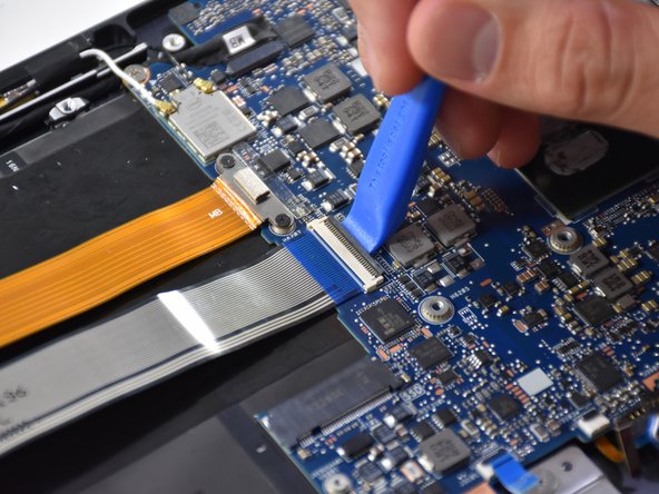

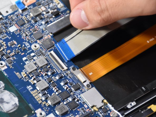

  17. Asus Q325U Motherboard Replacement: crwdns2935265:017crwdnd2935265:01crwdnd2935265:03crwdne2935265:0 Asus Q325U Motherboard Replacement: crwdns2935265:017crwdnd2935265:02crwdnd2935265:03crwdne2935265:0 Asus Q325U Motherboard Replacement: crwdns2935265:017crwdnd2935265:03crwdnd2935265:03crwdne2935265:0
    • Lift the black tab on the long white plastic piece of the thick blue band.
    • Remove the thick blue band by pulling.

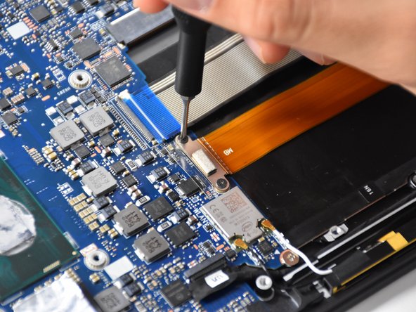

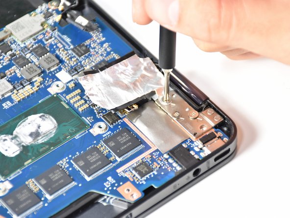

  18. Asus Q325U Motherboard Replacement: crwdns2935265:018crwdnd2935265:01crwdnd2935265:03crwdne2935265:0 Asus Q325U Motherboard Replacement: crwdns2935265:018crwdnd2935265:02crwdnd2935265:03crwdne2935265:0 Asus Q325U Motherboard Replacement: crwdns2935265:018crwdnd2935265:03crwdnd2935265:03crwdne2935265:0
    • Remove the two Phillips #000 screws on the metal connector above the thick orange band.
    • Lift up the thick orange band.

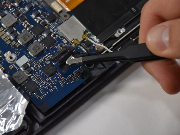

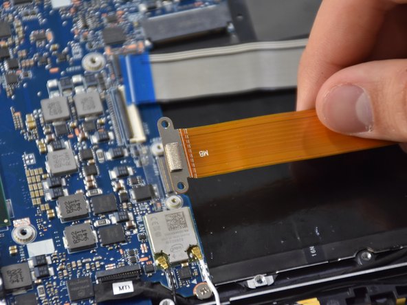

  19. Asus Q325U Motherboard Replacement: crwdns2935265:019crwdnd2935265:01crwdnd2935265:03crwdne2935265:0 Asus Q325U Motherboard Replacement: crwdns2935265:019crwdnd2935265:02crwdnd2935265:03crwdne2935265:0 Asus Q325U Motherboard Replacement: crwdns2935265:019crwdnd2935265:03crwdnd2935265:03crwdne2935265:0
    • Gently lift up the two smallest connectors using your fingers or a plastic opening tool.
  20. Asus Q325U Motherboard Replacement: crwdns2935265:020crwdnd2935265:01crwdnd2935265:02crwdne2935265:0 Asus Q325U Motherboard Replacement: crwdns2935265:020crwdnd2935265:02crwdnd2935265:02crwdne2935265:0
    • Lift up the black hinge of the connector using a plastic opening tool.
    • Remove the connector using a tweezer.
  21. Asus Q325U Motherboard Replacement: crwdns2935265:021crwdnd2935265:01crwdnd2935265:03crwdne2935265:0 Asus Q325U Motherboard Replacement: crwdns2935265:021crwdnd2935265:02crwdnd2935265:03crwdne2935265:0 Asus Q325U Motherboard Replacement: crwdns2935265:021crwdnd2935265:03crwdnd2935265:03crwdne2935265:0
    • Pull up the tap of the biggest connector using your fingers.
    • Lift the gold hinge using a plastic opening tool.
    • Lift the connector up with your fingers to remove.

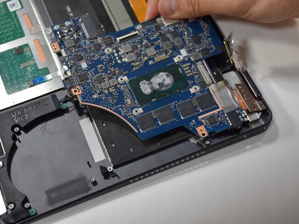

  22. Asus Q325U Motherboard Replacement: crwdns2935265:022crwdnd2935265:01crwdnd2935265:02crwdne2935265:0 Asus Q325U Motherboard Replacement: crwdns2935265:022crwdnd2935265:02crwdnd2935265:02crwdne2935265:0
    • Remove the four 4.8 mm screws using a Phillips #00 screwdriver.

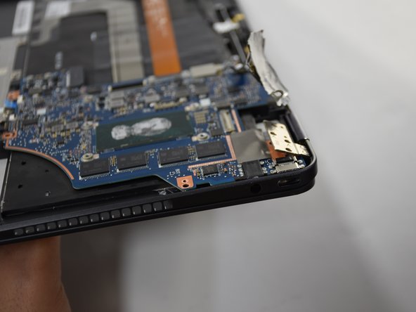

  23. Asus Q325U Motherboard Replacement: crwdns2935265:023crwdnd2935265:01crwdnd2935265:02crwdne2935265:0 Asus Q325U Motherboard Replacement: crwdns2935265:023crwdnd2935265:02crwdnd2935265:02crwdne2935265:0
    • Slightly open up the laptop. This will lift up the hinge at the corner and free the motherboard.
  24. Asus Q325U Motherboard Replacement: crwdns2935265:024crwdnd2935265:01crwdnd2935265:02crwdne2935265:0 Asus Q325U Motherboard Replacement: crwdns2935265:024crwdnd2935265:02crwdnd2935265:02crwdne2935265:0
    • Pull the motherboard away from the corner to remove.

Can you help me identify which of those is the webcam conector? I hava a faulty webcam and my guess is that it is a physical conection problem.
