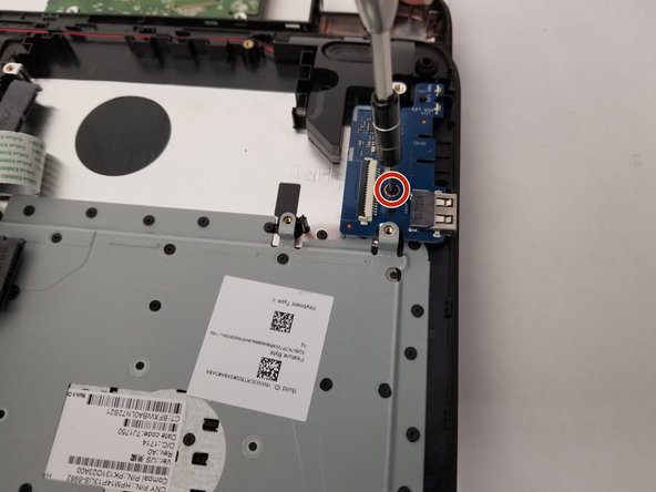

  • Remove the single 3mm JIS #0 screw.
  • Once the screw is out, the USB board can be pulled out for replacement.
