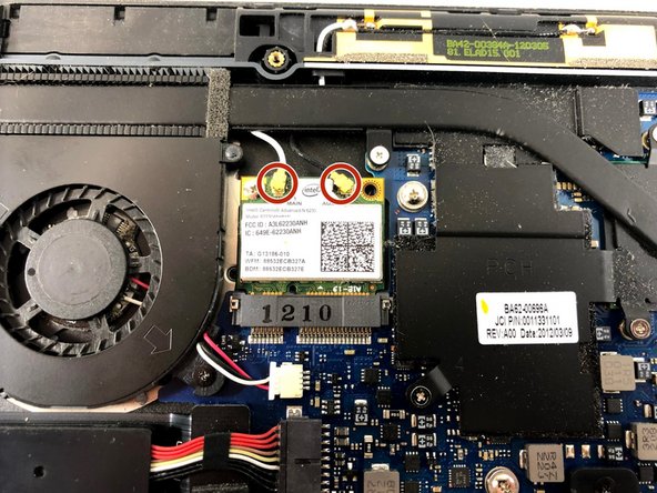

  • There will be two wires connecting to the Wifi Card from the laptop.
  • These wires can be removed with one of the plastic tools in the iFixit toolkit by applying slight force onto them.
  • After removing the wires move on to the next step.
