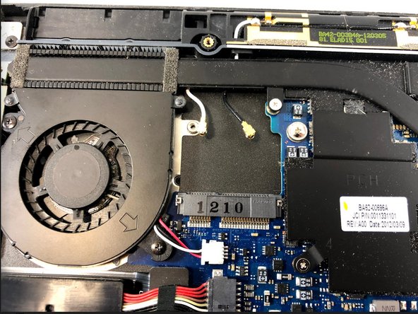

    • In order to continue, you need to observe the inside of the laptop and find where the Wifi Card is located.
  3. Samsung NP900X4B Wifi Card Replacement: crwdns2935265:03crwdnd2935265:01crwdnd2935265:01crwdne2935265:0
    • After finding the Wifi Card, you will discover two more 2.5mm Phillips #00 screws which hold the card in place.
    • The screws locations are shown in the image.
    • The same bit piece will be used to unscrew these (PH00/PH000). After completing this continue to the next step.

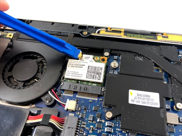

  4. Samsung NP900X4B Wifi Card Replacement: crwdns2935265:04crwdnd2935265:01crwdnd2935265:02crwdne2935265:0 Samsung NP900X4B Wifi Card Replacement: crwdns2935265:04crwdnd2935265:02crwdnd2935265:02crwdne2935265:0
    • There will be two wires connecting to the Wifi Card from the laptop.
    • These wires can be removed with one of the plastic tools in the iFixit toolkit by applying slight force onto them.
    • After removing the wires move on to the next step.
  5. Samsung NP900X4B Wifi Card Replacement: crwdns2935265:05crwdnd2935265:01crwdnd2935265:02crwdne2935265:0 Samsung NP900X4B Wifi Card Replacement: crwdns2935265:05crwdnd2935265:02crwdnd2935265:02crwdne2935265:0
    • This last step is the easiest of them all, all you need to do it pick up the Wifi Card from its position and you're done!
    • Now you are able to replace the card by following these steps in reverse or have the card further repaired.
