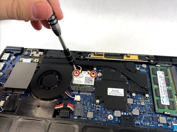

  • After finding the Wifi Card, you will discover two more 2.5mm Phillips #00 screws which hold the card in place.
  • The screws locations are shown in the image.
  • The same bit piece will be used to unscrew these (PH00/PH000). After completing this continue to the next step.
