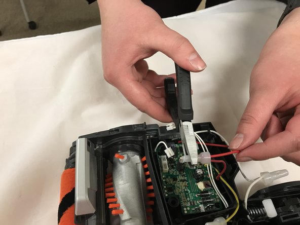

  • Squeeze the three plastic caps enclosing the crimped connection of the red, black and yellow wires extending outward from the motherboard to release the wires from the grip of the plastic caps.
  • You may have to adjust how you are squeezing the plastic caps to get the connection to release.
