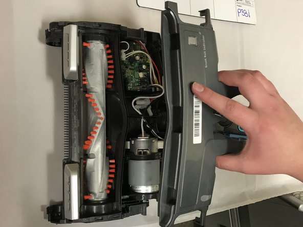

    • Press and slide the “access brush roll” buttons towards the text and lift plastic brush roll cover off.

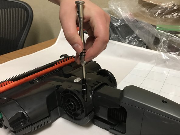

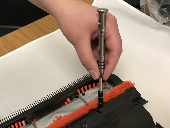

    • Use a T20 screwdriver to unscrew the 12.3 mm screw beneath the cover you just removed.

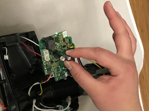

    • Squeeze tabs and remove small white plug with two white wires coming out of it.
  13. Shark IONFlex 2X Motherboard Replacement: crwdns2935265:013crwdnd2935265:01crwdnd2935265:01crwdne2935265:0
    • Squeeze tabs and remove small white plug with white and black wires coming out of it.

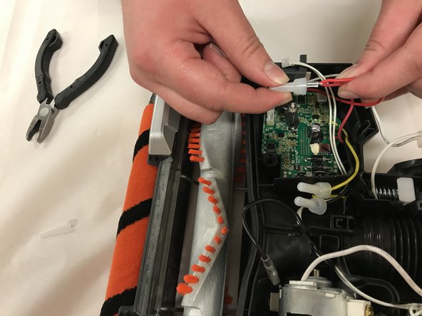

    • Squeeze the three plastic caps enclosing the crimped connection of the red, black and yellow wires extending outward from the motherboard to release the wires from the grip of the plastic caps.
    • You may have to adjust how you are squeezing the plastic caps to get the connection to release.
  15. Shark IONFlex 2X Motherboard Replacement: crwdns2935265:015crwdnd2935265:01crwdnd2935265:03crwdne2935265:0 Shark IONFlex 2X Motherboard Replacement: crwdns2935265:015crwdnd2935265:02crwdnd2935265:03crwdne2935265:0 Shark IONFlex 2X Motherboard Replacement: crwdns2935265:015crwdnd2935265:03crwdnd2935265:03crwdne2935265:0

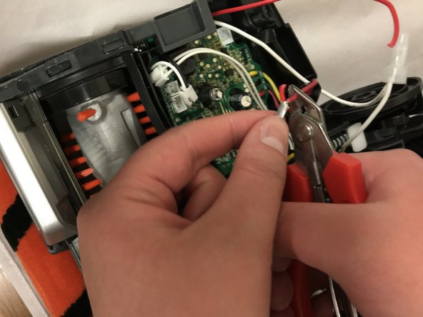

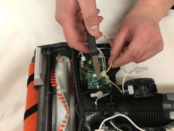

    • Remove the caps from the red, black and yellow wires to expose the three metal clamps.
  16. Shark IONFlex 2X Motherboard Replacement: crwdns2935265:016crwdnd2935265:01crwdnd2935265:02crwdne2935265:0 Shark IONFlex 2X Motherboard Replacement: crwdns2935265:016crwdnd2935265:02crwdnd2935265:02crwdne2935265:0
    • Cut the red wires extending beneath the metal clamp, right below the metal clamp holding the two wires together. Repeat process for black and yellow wires.

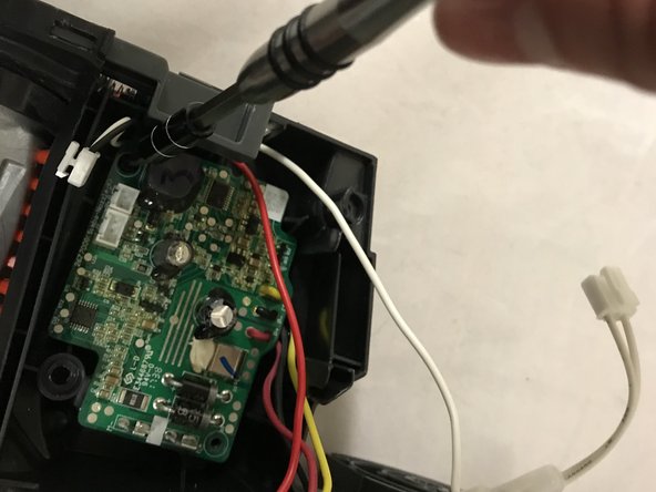

    • Unscrew the two 11.8mm screws in the motherboard using a T10 screwdriver.
  18. Shark IONFlex 2X Motherboard Replacement: crwdns2935265:018crwdnd2935265:01crwdnd2935265:02crwdne2935265:0 Shark IONFlex 2X Motherboard Replacement: crwdns2935265:018crwdnd2935265:02crwdnd2935265:02crwdne2935265:0
    • Remove the motherboard.
