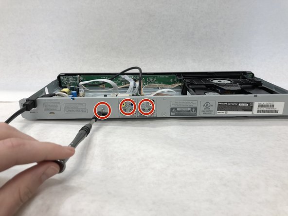

  • Remove the three 4.76 mm #1 Phillips head screws located on the back of the DVD player.
