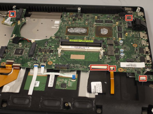

  • Disconnect the five cables that are attached to the motherboard by gently pulling them.
  • Disconnect the four remaining cables attached to the motherboard by lifting the tabs and gently pulling them out.
