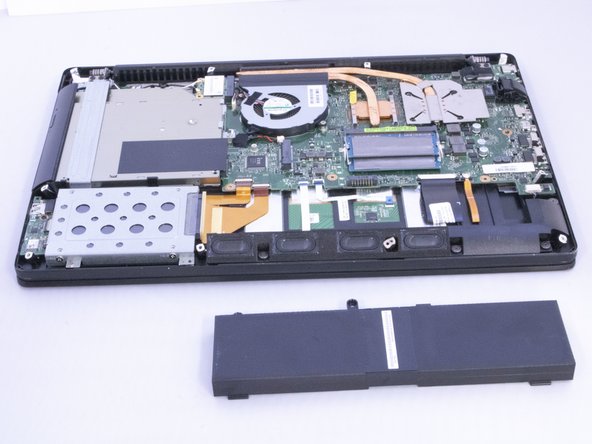

    • Use a Phillips #0 screwdriver head to remove the three black 7mm Phillips head screws that hold the battery in place.
  4. Asus Q550LF-BBI7T07 Motherboard Replacement: crwdns2935265:04crwdnd2935265:01crwdnd2935265:02crwdne2935265:0 Asus Q550LF-BBI7T07 Motherboard Replacement: crwdns2935265:04crwdnd2935265:02crwdnd2935265:02crwdne2935265:0
    • Once the screws have been removed, gently lift the battery out.

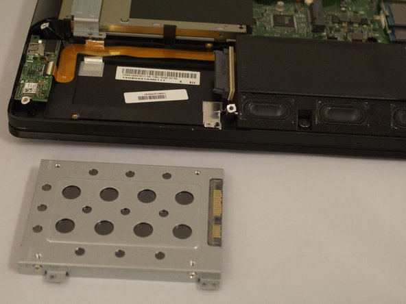

  5. Asus Q550LF-BBI7T07 Motherboard Replacement, Hard Drive: crwdns2935265:05crwdnd2935265:01crwdnd2935265:02crwdne2935265:0 Asus Q550LF-BBI7T07 Motherboard Replacement, Hard Drive: crwdns2935265:05crwdnd2935265:02crwdnd2935265:02crwdne2935265:0
    • Use the Phillips #0 Screwdriver to unscrew the four silver 5mm screws.
  6. Asus Q550LF-BBI7T07 Motherboard Replacement: crwdns2935265:06crwdnd2935265:01crwdnd2935265:02crwdne2935265:0 Asus Q550LF-BBI7T07 Motherboard Replacement: crwdns2935265:06crwdnd2935265:02crwdnd2935265:02crwdne2935265:0
    • Gently disconnect the Hard Drive from the connector cable. Lift it out and remove it.

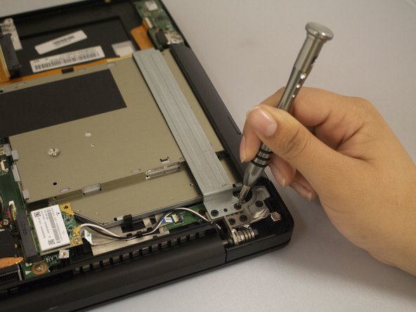

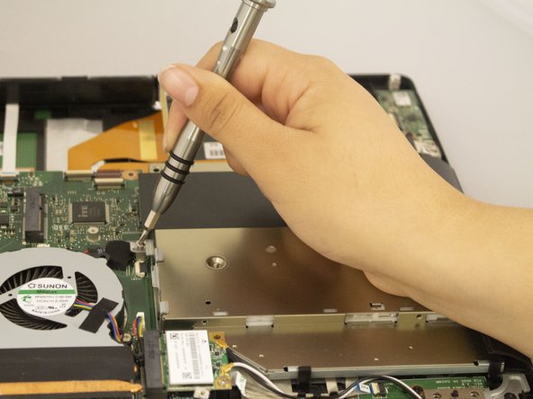

  7. Asus Q550LF-BBI7T07 Motherboard Replacement, Disc Drive: crwdns2935265:07crwdnd2935265:01crwdnd2935265:02crwdne2935265:0 Asus Q550LF-BBI7T07 Motherboard Replacement, Disc Drive: crwdns2935265:07crwdnd2935265:02crwdnd2935265:02crwdne2935265:0
    • Use the Phillips #0 screwdriver to remove the two 7mm Phillips head screws from the metal disc drive holder.
  8. Asus Q550LF-BBI7T07 Motherboard Replacement: crwdns2935265:08crwdnd2935265:01crwdnd2935265:01crwdne2935265:0
    • Lift the metal disc drive holder off of the disc drive to remove it.
  9. Asus Q550LF-BBI7T07 Motherboard Replacement: crwdns2935265:09crwdnd2935265:01crwdnd2935265:02crwdne2935265:0 Asus Q550LF-BBI7T07 Motherboard Replacement: crwdns2935265:09crwdnd2935265:02crwdnd2935265:02crwdne2935265:0
    • Use the Phillips #0 screwdriver to unscrew the one silver 5mm Phillips head screw that connects the disc drive to the motherboard.
  10. Asus Q550LF-BBI7T07 Motherboard Replacement: crwdns2935265:010crwdnd2935265:01crwdnd2935265:02crwdne2935265:0 Asus Q550LF-BBI7T07 Motherboard Replacement: crwdns2935265:010crwdnd2935265:02crwdnd2935265:02crwdne2935265:0
    • Slowly slide out the disc drive, keeping it level, to remove it.

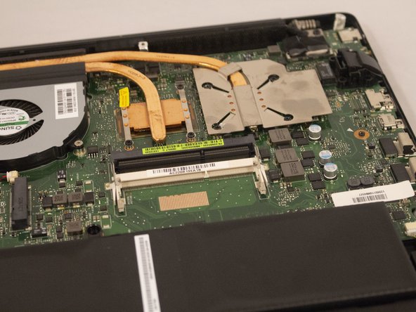

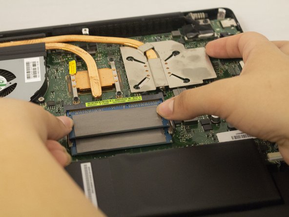

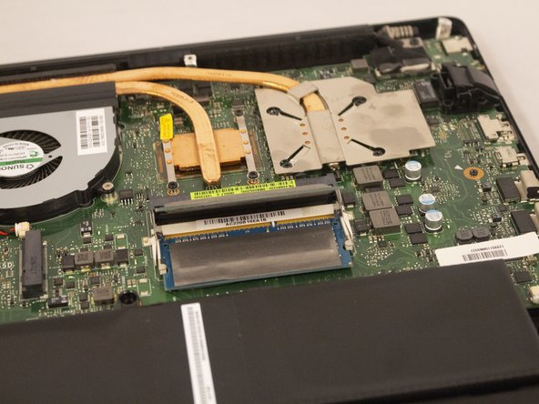

  11. Asus Q550LF-BBI7T07 Motherboard Replacement, RAM: crwdns2935265:011crwdnd2935265:01crwdnd2935265:03crwdne2935265:0 Asus Q550LF-BBI7T07 Motherboard Replacement, RAM: crwdns2935265:011crwdnd2935265:02crwdnd2935265:03crwdne2935265:0 Asus Q550LF-BBI7T07 Motherboard Replacement, RAM: crwdns2935265:011crwdnd2935265:03crwdnd2935265:03crwdne2935265:0
    • Push both metal tabs away from each other on each side of the RAM farthest from battery so that the RAM will pop up.
  12. Asus Q550LF-BBI7T07 Motherboard Replacement: crwdns2935265:012crwdnd2935265:01crwdnd2935265:01crwdne2935265:0
    • Pull out first RAM chip.
  13. Asus Q550LF-BBI7T07 Motherboard Replacement: crwdns2935265:013crwdnd2935265:01crwdnd2935265:01crwdne2935265:0
    • Push both metal tabs away from each other on each side of the RAM closest to the battery so that the second RAM will pop up.
  14. Asus Q550LF-BBI7T07 Motherboard Replacement: crwdns2935265:014crwdnd2935265:01crwdnd2935265:02crwdne2935265:0 Asus Q550LF-BBI7T07 Motherboard Replacement: crwdns2935265:014crwdnd2935265:02crwdnd2935265:02crwdne2935265:0
    • Pull out second RAM chip.

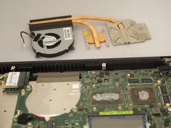

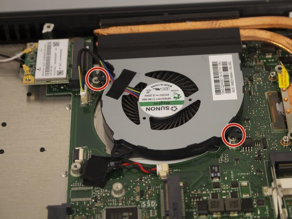

  15. Asus Q550LF-BBI7T07 Motherboard Replacement, Motherboard: crwdns2935265:015crwdnd2935265:01crwdnd2935265:03crwdne2935265:0 Asus Q550LF-BBI7T07 Motherboard Replacement, Motherboard: crwdns2935265:015crwdnd2935265:02crwdnd2935265:03crwdne2935265:0 Asus Q550LF-BBI7T07 Motherboard Replacement, Motherboard: crwdns2935265:015crwdnd2935265:03crwdnd2935265:03crwdne2935265:0
    • Remove the ten screws surrounding the fan and cooling assembly using a Phillips #0 screwdriver.
    • Remove the two silver 5 mm Phillips head screws that hold the fan in place.
    • Remove the eight black 4 mm Phillips head screws that hold the fan in place.
  16. Asus Q550LF-BBI7T07 Motherboard Replacement: crwdns2935265:016crwdnd2935265:01crwdnd2935265:02crwdne2935265:0 Asus Q550LF-BBI7T07 Motherboard Replacement: crwdns2935265:016crwdnd2935265:02crwdnd2935265:02crwdne2935265:0
    • Disconnect the multi-colored cable that attaches the fan to the motherboard.
    • Pick the fan up to remove it from the motherboard.

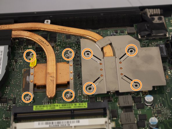

  17. Asus Q550LF-BBI7T07 Motherboard Replacement: crwdns2935265:017crwdnd2935265:01crwdnd2935265:03crwdne2935265:0 Asus Q550LF-BBI7T07 Motherboard Replacement: crwdns2935265:017crwdnd2935265:02crwdnd2935265:03crwdne2935265:0 Asus Q550LF-BBI7T07 Motherboard Replacement: crwdns2935265:017crwdnd2935265:03crwdnd2935265:03crwdne2935265:0

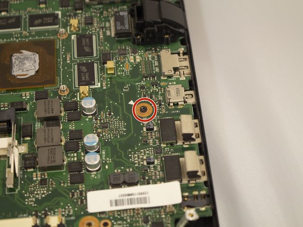

    • Use the Phillips #0 Screwdriver to remove the four screws on the edge of the motherboard;
    • Remove the one black 3 mm screw.
    • Remove the three silver 5 mm screws.

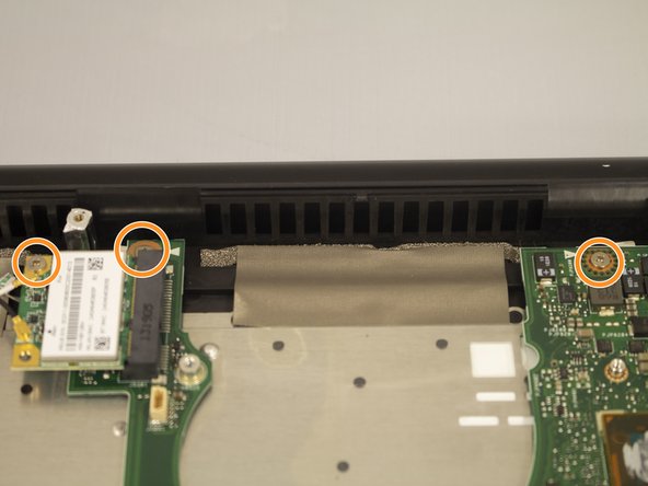

  18. Asus Q550LF-BBI7T07 Motherboard Replacement: crwdns2935265:018crwdnd2935265:01crwdnd2935265:01crwdne2935265:0
    • Use the Phillips #0 Screwdriver to remove the remaining four black 7 mm screws on the edge of the motherboard.

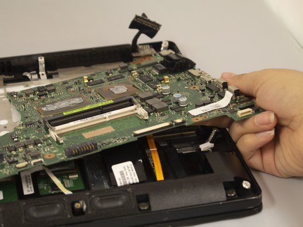

  19. Asus Q550LF-BBI7T07 Motherboard Replacement: crwdns2935265:019crwdnd2935265:01crwdnd2935265:02crwdne2935265:0 Asus Q550LF-BBI7T07 Motherboard Replacement: crwdns2935265:019crwdnd2935265:02crwdnd2935265:02crwdne2935265:0
    • Disconnect the five cables that are attached to the motherboard by gently pulling them.
    • Disconnect the four remaining cables attached to the motherboard by lifting the tabs and gently pulling them out.
  20. Asus Q550LF-BBI7T07 Motherboard Replacement: crwdns2935265:020crwdnd2935265:01crwdnd2935265:02crwdne2935265:0 Asus Q550LF-BBI7T07 Motherboard Replacement: crwdns2935265:020crwdnd2935265:02crwdnd2935265:02crwdne2935265:0
    • Use the metal spudger to pry and lift the silver hinge that is connected to the motherboard to release it.
    • Pull the motherboard out by hand in a counterclockwise motion to remove it.
