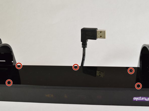

  • Flip the top bar over and using a #00 phillips head screwdriver, remove the five 7mm screws holding the bar together.
