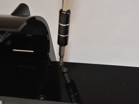

    • Remove the top bar by removing the 5cm hex T10 screws on the back of the device as shown. Then gently pull off the top bar from the main component.
  2. Purple SmartVP Light Replacement: crwdns2935265:02crwdnd2935265:01crwdnd2935265:02crwdne2935265:0 Purple SmartVP Light Replacement: crwdns2935265:02crwdnd2935265:02crwdnd2935265:02crwdne2935265:0
    • Remove the 1.2 cm hex T9 screws and gently open up the device.

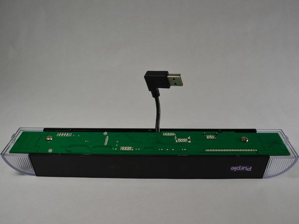

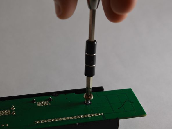

  3. Purple SmartVP Light Replacement: crwdns2935265:03crwdnd2935265:01crwdnd2935265:02crwdne2935265:0 Purple SmartVP Light Replacement: crwdns2935265:03crwdnd2935265:02crwdnd2935265:02crwdne2935265:0
    • Flip the top bar over and using a #00 phillips head screwdriver, remove the five 7mm screws holding the bar together.

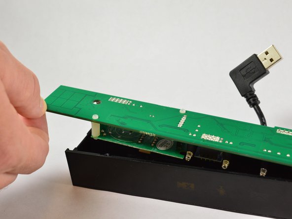

  4. Purple SmartVP Light Replacement: crwdns2935265:04crwdnd2935265:01crwdnd2935265:02crwdne2935265:0 Purple SmartVP Light Replacement: crwdns2935265:04crwdnd2935265:02crwdnd2935265:02crwdne2935265:0
    • Carefully pry off the plastic panel, revealing the motherboard.
  5. Purple SmartVP Light Replacement: crwdns2935265:05crwdnd2935265:01crwdnd2935265:02crwdne2935265:0 Purple SmartVP Light Replacement: crwdns2935265:05crwdnd2935265:02crwdnd2935265:02crwdne2935265:0
    • Remove the two 7mm screws holding the motherboard in place with a phillips head screwdriver size #00.

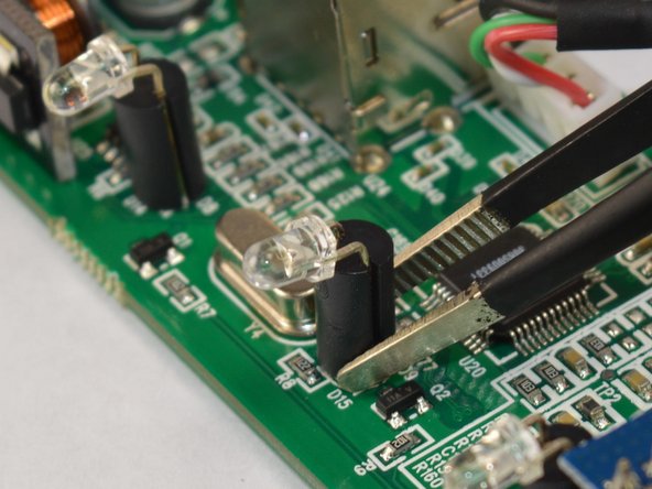

  7. Purple SmartVP Light Replacement: crwdns2935265:07crwdnd2935265:01crwdnd2935265:02crwdne2935265:0 Purple SmartVP Light Replacement: crwdns2935265:07crwdnd2935265:02crwdnd2935265:02crwdne2935265:0
    • Heat the solder on the underside of the affected light to remove and replace it using tweezers.
    • Check out this helpful guide for some soldering and desoldering tips.
