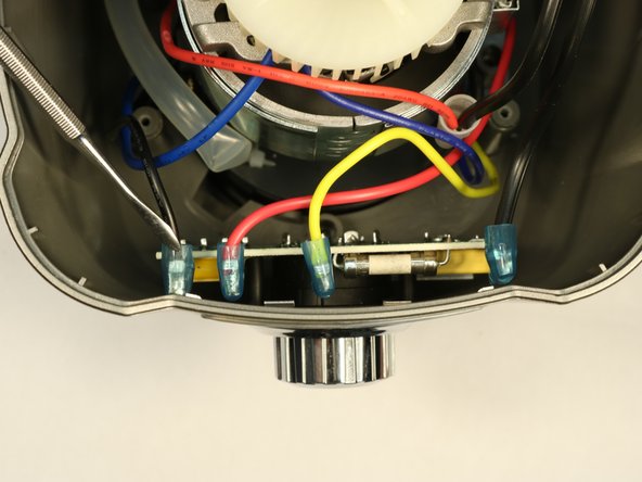

  • Remove the 2 black, yellow, and red wires from circuit board by push down on the tab to release and then pull up.
