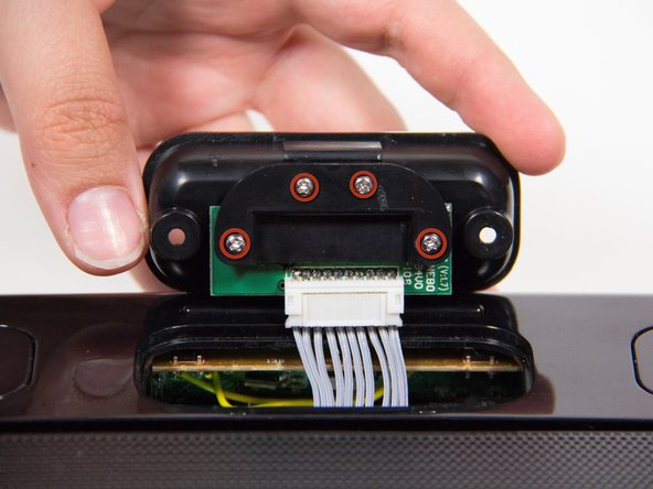

  • Remove the following screws:
  • Four 7 mm Phillips #0
  • Lift up the two black plastic pieces that have come loose on either side of the circuit board, and set them aside.
