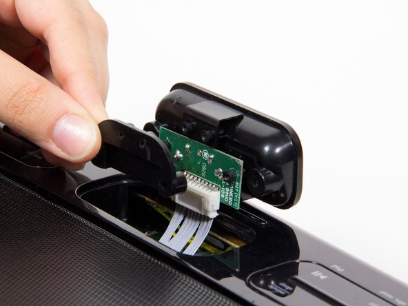

      • Set the IHome on a surface facing upward.
      • Locate the two screws on the docking station adapter.
      • Remove the following screws:
      • Two 10 mm Phillips #0
    2. iHome iH27B iPod Adapter Replacement: crwdns2935265:02crwdnd2935265:01crwdnd2935265:01crwdne2935265:0
      • Grip the plastic adapter case and pull upwards with a medium amount of force. You will have to twist forward a little so that the connections are visible.
      • The adapter will still be connected with wires, so make sure not to pull too hard.

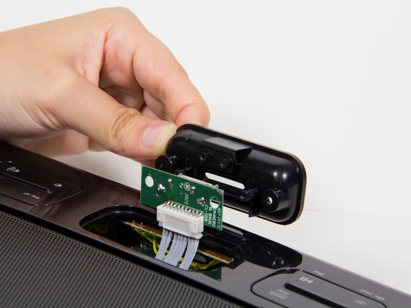

      • Four 7 mm Phillips #0
      • Lift up the two black plastic pieces that have come loose on either side of the circuit board, and set them aside.

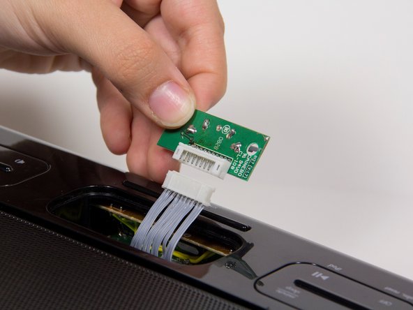

      • Carefully pry apart the bundle of white wires connected at the junction with the plastic opening tool.
      • Do this slowly. Be careful not to damage the wires
      • Lift up the circuit board that has become loose.
    5. iHome iH27B iPod Adapter Replacement: crwdns2935265:05crwdnd2935265:01crwdnd2935265:01crwdne2935265:0
      • Pull out the adapter, and replace it with the new one.
