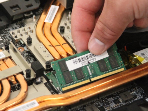

  • Lift and remove RAM card by hand. Replace each RAM card and test them individually. If your computer encounters a RAM error with only one card inserted, you can confirm that card is corrupted.
