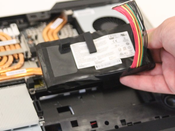

    • Disconnect the battery cable.
  4. MSI GT75VR 7RF Titan Pro RAM Card Replacement: crwdns2935265:04crwdnd2935265:01crwdnd2935265:02crwdne2935265:0 MSI GT75VR 7RF Titan Pro RAM Card Replacement: crwdns2935265:04crwdnd2935265:02crwdnd2935265:02crwdne2935265:0
    • Pry the battery pack up with the black nylon spudger.
