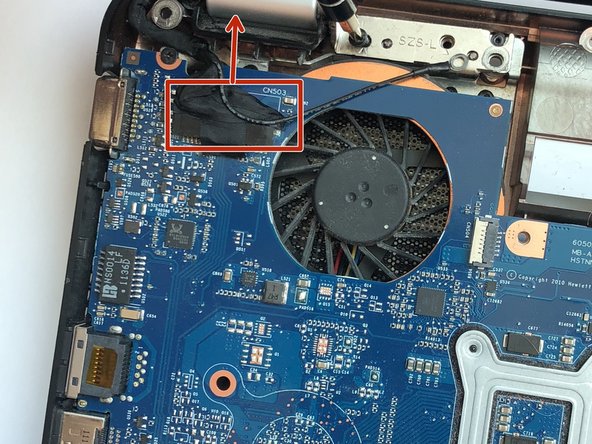

  • Lift the tape tab up from the screen plug, and unplug the screen from the motherboard.
  • Unplug the wires from the wireless card and pull them through the body.
