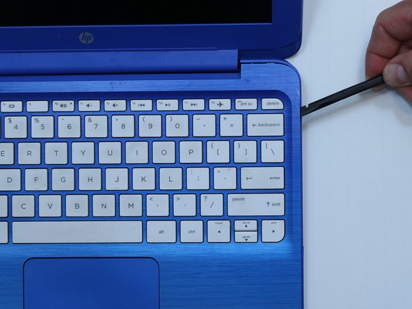

  • Turn the computer over and open it.
  • Use a plastic spudger to pry the keyboard bezel away from the base. Pry around the edge, being careful not to jam the spudger too far underneath the bezel (potentially damaging internal components).
  • The bezel is tightest near the hinge.
  • Once the bezel is free, do not lift it away from the base.
