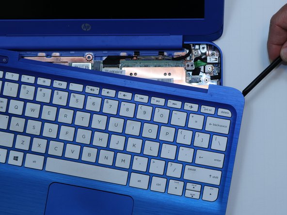

    • Turn the computer over and open it.
    • Use a plastic spudger to pry the keyboard bezel away from the base. Pry around the edge, being careful not to jam the spudger too far underneath the bezel (potentially damaging internal components).
    • The bezel is tightest near the hinge.
    • Once the bezel is free, do not lift it away from the base.

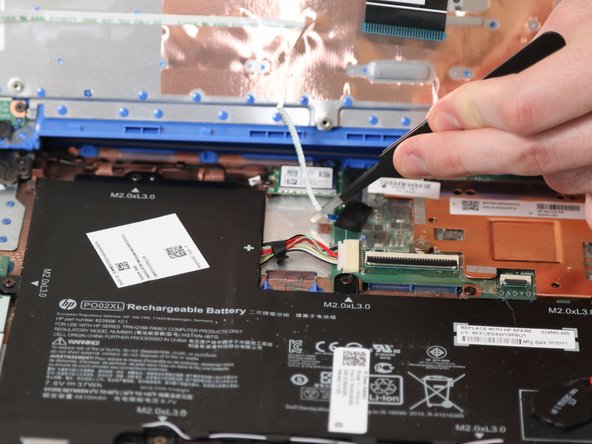

    • Identify two ribbon connectors and the ZIF cable underneath the keyboard.
    • Use tweezers to disconnect both ribbon cables and the ZIF connector.

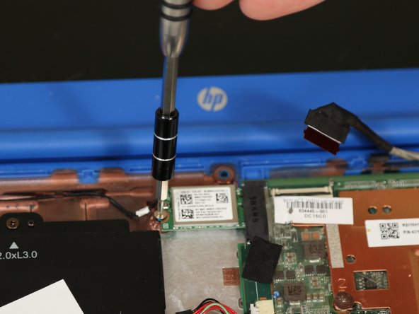

    • Use tweezers to disconnect the black power cable.
    • Remove the 3.5 millimeter screw from the WiFi chip using a #00 Phillips head screwdriver.
    • The upper and lower halves of the laptop should now be separated.

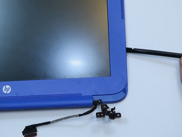

    • Remove two 2 millimeter bezel screws using a #00 Phillips screwdriver.
    • Use a plastic spudger to pry the bezel away from the screen.
    • The bezel screws are covered by thin plastic.
