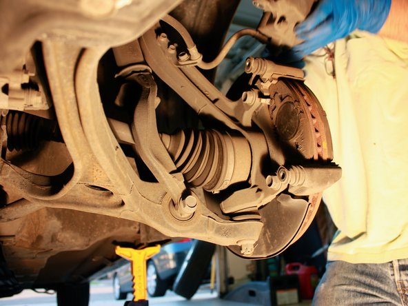

  • Slide the caliper over the brake pad bracket with the new brake pads.
  • If you removed the cap from the brake fluid reservoir replace it as soon as the brake caliper piston has been retracted. Do not leave the cap off any longer than absolutely necessary.
