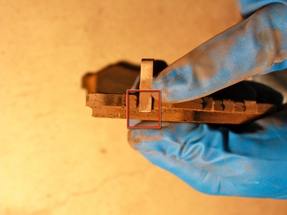

  • Inspect the brake pad wear sensor on the old brake pad. The sensor is a metallic tab attached to the brake pad. When the brake pads wear down too much, the metallic tab contacts the rotor and makes a screeching sound.
