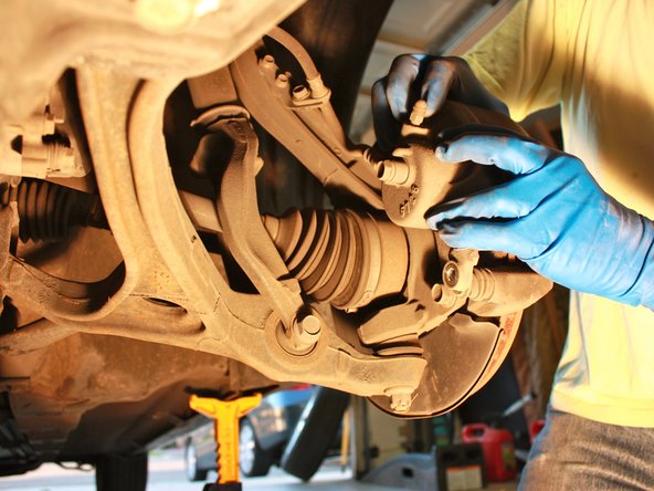

  • Slide the caliper off and rest it on the top of the rotor.
  • Do not let the caliper hang freely because the brake lines may stretch and weaken.
