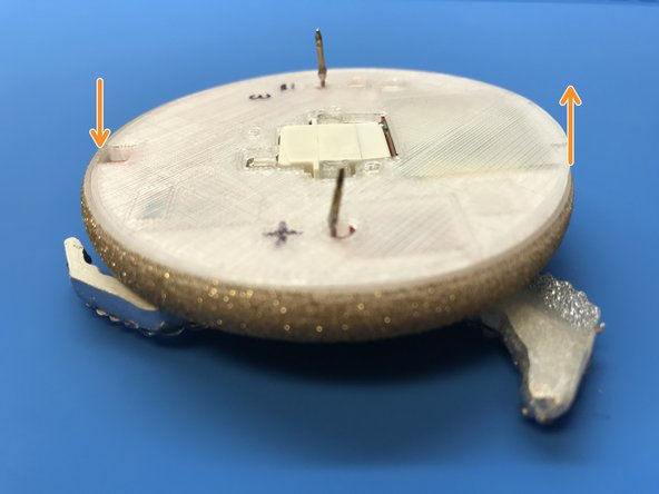

Assemble back of enclosure
  • Start by placing the bottom notched-side into the lip of the enclosure.
  • Align all three mounting holes from above.
  • Press firmly with both hands (avoid putting pressure on horse) and work your hands around the edges until the back is pressed flush.
  • Secure the back of the enclosure by driving three M2 screws into place. DO NOT OVER TIGHTEN!
