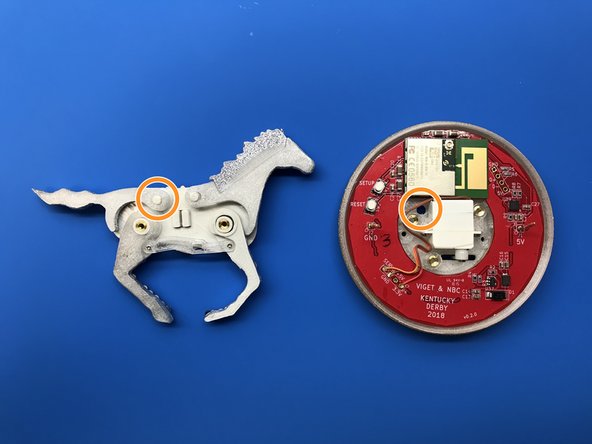

Mount horse to enclosure
  • Align the enclosure with the mounting holes on the backside of the horse's body.
  • Align servo arm with the drive gap in the linkage. Double check this correct before tightening.
  • Use two M2 screws to attach the horse to the enclosure.
