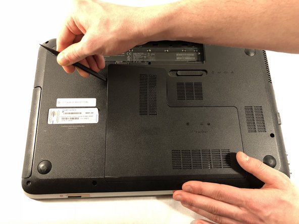

  • Slide the spudger down the left side of the cover to loosen the clips.
  • After the left side is loose, the rest of the cover should pop off, and you can remove it with your hands.
  • When reassembling, insert the bottom of the cover first, and then firmly press along the edges from bottom to top to secure it in place.
