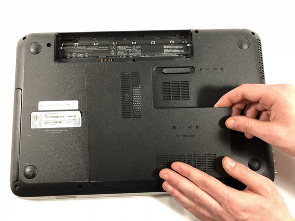

    • Begin removing the bottom cover by sliding the battery removal slider to the right to pop off the top of the cover.
  2. HP Pavilion dv6-6117dx Optical Drive Replacement: crwdns2935265:02crwdnd2935265:01crwdnd2935265:02crwdne2935265:0 HP Pavilion dv6-6117dx Optical Drive Replacement: crwdns2935265:02crwdnd2935265:02crwdnd2935265:02crwdne2935265:0
    • Slide a black spudger under the top of the cover to loosen the clips underneath.
  3. HP Pavilion dv6-6117dx Optical Drive Replacement: crwdns2935265:03crwdnd2935265:01crwdnd2935265:03crwdne2935265:0 HP Pavilion dv6-6117dx Optical Drive Replacement: crwdns2935265:03crwdnd2935265:02crwdnd2935265:03crwdne2935265:0 HP Pavilion dv6-6117dx Optical Drive Replacement: crwdns2935265:03crwdnd2935265:03crwdnd2935265:03crwdne2935265:0
    • Slide the spudger down the left side of the cover to loosen the clips.
    • After the left side is loose, the rest of the cover should pop off, and you can remove it with your hands.
    • When reassembling, insert the bottom of the cover first, and then firmly press along the edges from bottom to top to secure it in place.
