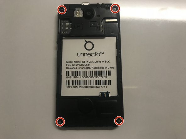

  • Remove the four screws on the back of the phone using a Philips 000 screwdriver
