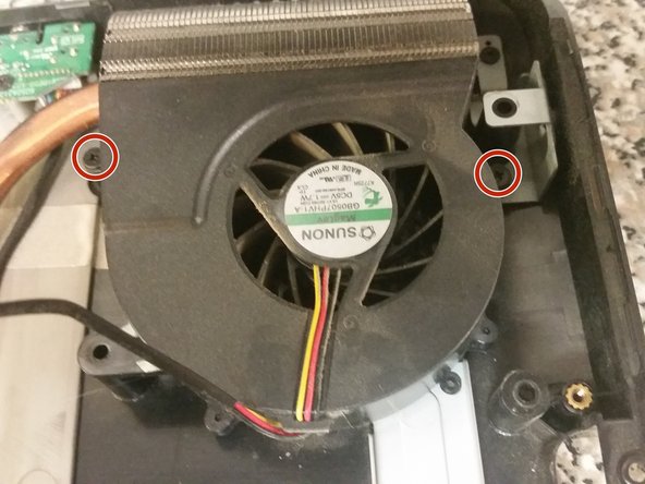

HP Pavilion HDX9000 Motherboard Replacement, Remove CPU fan: crwdns2935265:00crwdnd2935265:01crwdnd2935265:01crwdne2935265:0
Remove CPU fan
  • Remove the two M2.5x8 screws securing the CPU fan to the base, and remove the fan.
