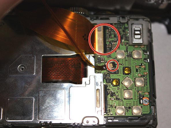

  • Use the tip of the spudger to flip up the black tabs on the ribbon cables.
  • Pull gently on the ribbon cables to unseat them.
