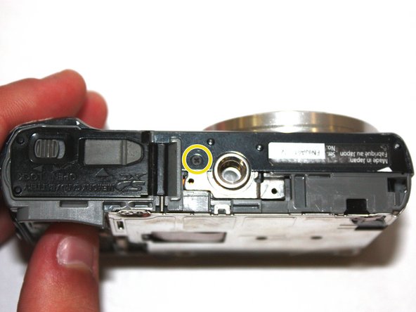

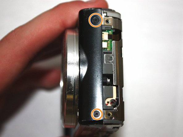

    • Unscrew the two 1.0 mm screws on the bottom with a Phillips #000 screwdriver.
    • Unscrew the two 1.0 mm screws to the left with a Phillips #000 screwdriver.
    • Unscrew the two 1.0 mm screws to the right with a Phillips #000 screwdriver.

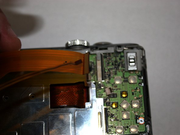

  4. Panasonic Lumix DMC-ZS6 Flash Assembly Replacement: crwdns2935265:04crwdnd2935265:01crwdnd2935265:02crwdne2935265:0 Panasonic Lumix DMC-ZS6 Flash Assembly Replacement: crwdns2935265:04crwdnd2935265:02crwdnd2935265:02crwdne2935265:0
    • Use the tip of the spudger to flip up the black tabs on the ribbon cables.
    • Pull gently on the ribbon cables to unseat them.

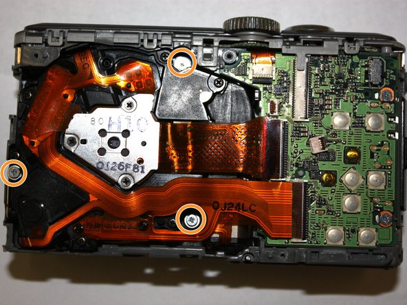

  5. Panasonic Lumix DMC-ZS6 Flash Assembly Replacement: crwdns2935265:05crwdnd2935265:01crwdnd2935265:03crwdne2935265:0 Panasonic Lumix DMC-ZS6 Flash Assembly Replacement: crwdns2935265:05crwdnd2935265:02crwdnd2935265:03crwdne2935265:0 Panasonic Lumix DMC-ZS6 Flash Assembly Replacement: crwdns2935265:05crwdnd2935265:03crwdnd2935265:03crwdne2935265:0
    • Unscrew the 1.0 mm screws to the left with Phillips #000 screwdriver.
    • Unscrew the 1.0 mm screws to the right with Phillips #000 screwdriver.
    • Unscrew the one bottom 1.0 mm screw with a Phillips #000 screwdriver.

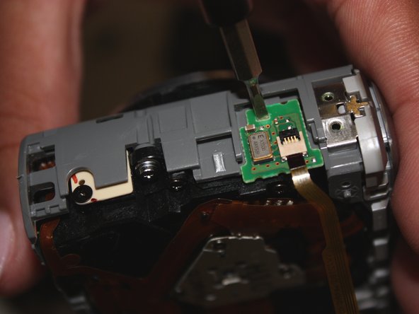

  7. Panasonic Lumix DMC-ZS6 Flash Assembly Replacement: crwdns2935265:07crwdnd2935265:01crwdnd2935265:02crwdne2935265:0 Panasonic Lumix DMC-ZS6 Flash Assembly Replacement: crwdns2935265:07crwdnd2935265:02crwdnd2935265:02crwdne2935265:0
    • Use the tip of the spudger to disengage the plastic tab.
    • Lift the selector switch away from the motherboard carefully.

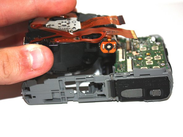

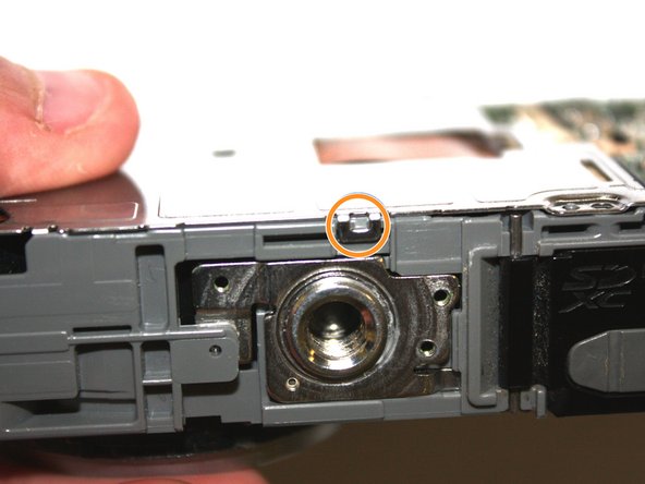

  9. Panasonic Lumix DMC-ZS6 Flash Assembly Replacement: crwdns2935265:09crwdnd2935265:01crwdnd2935265:01crwdne2935265:0
    • Insert the tip of the spudger into the center hole of the tripod mount, and apply force in the direction facing away from the button.
    • Lift the tripod mount out of the camera body carefully.

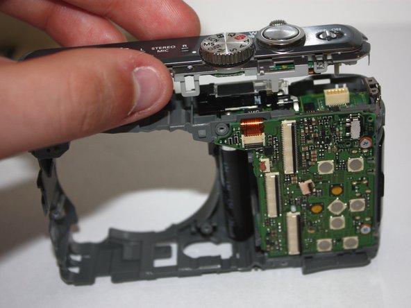

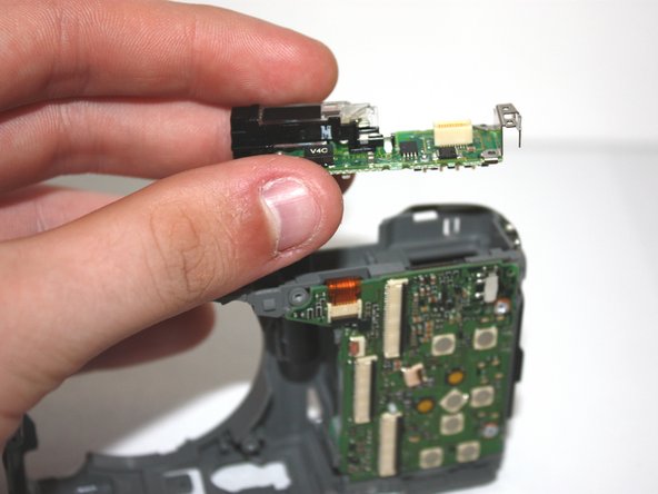

  12. Panasonic Lumix DMC-ZS6 Flash Assembly Replacement: crwdns2935265:012crwdnd2935265:01crwdnd2935265:03crwdne2935265:0 Panasonic Lumix DMC-ZS6 Flash Assembly Replacement: crwdns2935265:012crwdnd2935265:02crwdnd2935265:03crwdne2935265:0 Panasonic Lumix DMC-ZS6 Flash Assembly Replacement: crwdns2935265:012crwdnd2935265:03crwdnd2935265:03crwdne2935265:0
    • Use the tip of the spudger to disengage the tab on the back of the camera.
    • Use the tip of the spudger to disengage the two tabs on the front of the camera.
    • Lift the top assembly out of place carefully.

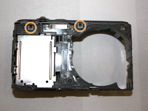

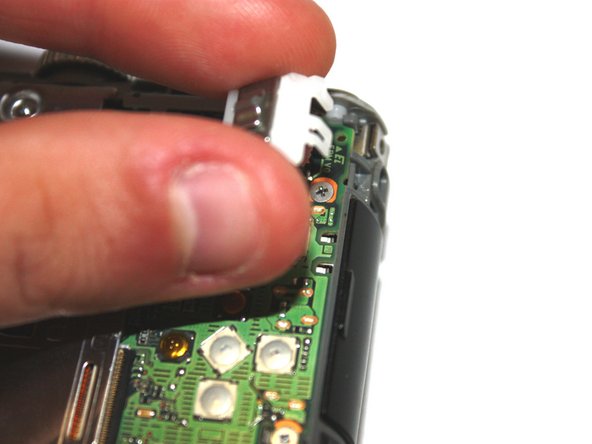

  13. Panasonic Lumix DMC-ZS6 Flash Assembly Replacement: crwdns2935265:013crwdnd2935265:01crwdnd2935265:02crwdne2935265:0 Panasonic Lumix DMC-ZS6 Flash Assembly Replacement: crwdns2935265:013crwdnd2935265:02crwdnd2935265:02crwdne2935265:0
    • Use the spudger to disengage the two tabs.
    • Lift the flash assembly out of place carefully.
