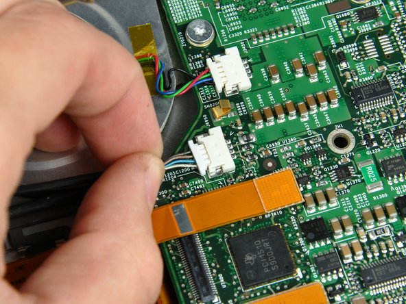

  • Disconnect the inverter cable from the logic board.
  • Be sure to pull only parallel to the face of the logic board, as pulling up on the socket will break it off the logic board.
  • When pulling this connector away from its socket, it is helpful to use your fingernails to pull on the ears at each side of the connector.
