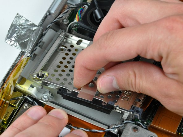

  20. PowerBook G4 Aluminum 17" 1.67 GHz (High-Res) Display Replacement: crwdns2935265:020crwdnd2935265:01crwdnd2935265:02crwdne2935265:0 PowerBook G4 Aluminum 17" 1.67 GHz (High-Res) Display Replacement: crwdns2935265:020crwdnd2935265:02crwdnd2935265:02crwdne2935265:0
    • Lift the PC card cage by its center piece and maneuver it out of the lower case.

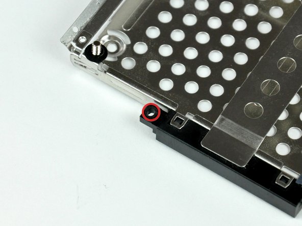

  21. PowerBook G4 Aluminum 17" 1.67 GHz (High-Res) Display Replacement: crwdns2935265:021crwdnd2935265:01crwdnd2935265:02crwdne2935265:0 PowerBook G4 Aluminum 17" 1.67 GHz (High-Res) Display Replacement: crwdns2935265:021crwdnd2935265:02crwdnd2935265:02crwdne2935265:0
    • When reinstalling your PC card cage, be sure to insert the post sticking up from the PC card release button into the hole in the black plastic release mechanism on the PC card cage.

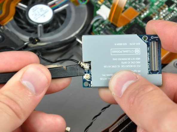

  26. PowerBook G4 Aluminum 17" 1.67 GHz (High-Res) Display Replacement: crwdns2935265:026crwdnd2935265:01crwdnd2935265:02crwdne2935265:0 PowerBook G4 Aluminum 17" 1.67 GHz (High-Res) Display Replacement: crwdns2935265:026crwdnd2935265:02crwdnd2935265:02crwdne2935265:0
    • Use the flat end of a spudger to pry both antenna connectors up off the AirPort/Bluetooth board.
