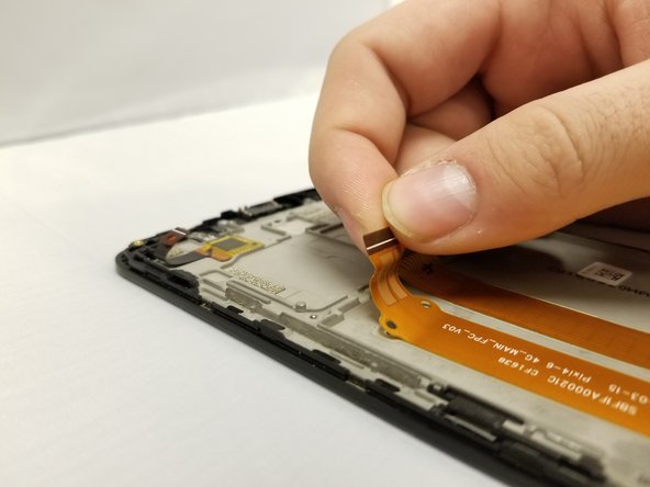

  • Do not damage the ribbon cable; you'll need to save it for reassembly.
  • Gently remove the outer ribbon cable by slowly peeling it away, starting with the top end.
