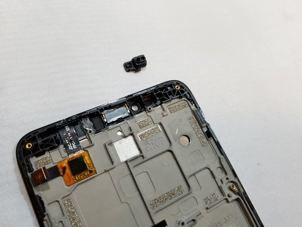

  17. Alcatel Pixi Theatre Touch Screen Display Assembly Replacement, Touch Screen Display Assembly: crwdns2935265:017crwdnd2935265:01crwdnd2935265:02crwdne2935265:0 Alcatel Pixi Theatre Touch Screen Display Assembly Replacement, Touch Screen Display Assembly: crwdns2935265:017crwdnd2935265:02crwdnd2935265:02crwdne2935265:0
    • Remove the camera's rubber seal by lifting it out with a pair of tweezers; it should come out easily.

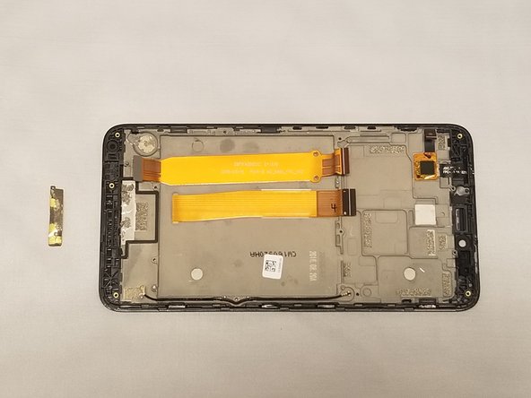

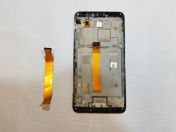

  19. Alcatel Pixi Theatre Touch Screen Display Assembly Replacement: crwdns2935265:019crwdnd2935265:01crwdnd2935265:02crwdne2935265:0 Alcatel Pixi Theatre Touch Screen Display Assembly Replacement: crwdns2935265:019crwdnd2935265:02crwdnd2935265:02crwdne2935265:0
    • Do not damage the ribbon cable; you'll need to save it for reassembly.
    • Gently remove the outer ribbon cable by slowly peeling it away, starting with the top end.
